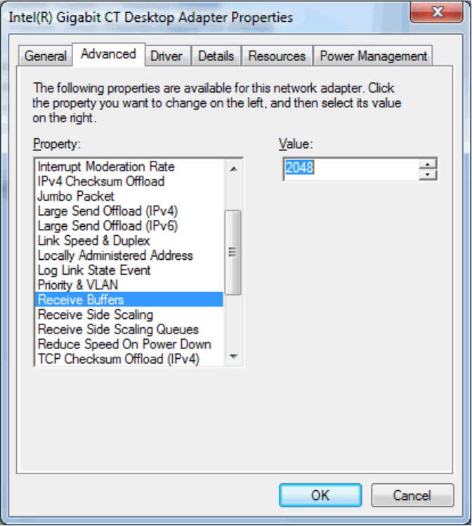

Make sure that the network card’s settings for receive buffer size and MTU are as high as possible.
Receive Buffer Size
../_images/network_receive_buffers1.png
On Windows you can open the Device Manager and open the properties dialog of your network card. Select the Advanced tab and find the entry for the receive buffers and set them as high as possible.

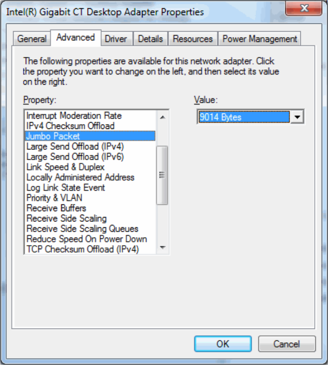

Maximum Transmission Unit (MTU)
GigE Vision based cameras can use Jumbo Frames when all participating network hardware supports it. This means that the image data gets split up into less network packets, leading to a more reliable image transfer.
If you have any additional network devices between the camera and your network adapter, you should make sure that Jumbo Frames are enabled on all of them. NxView will also show a warning when the camera cannot use high packet sizes.
../_images/network_mtu1.png
On Windows you can open the Device Manager and open the properties dialog of your network card. Select the Advanced tab and find the entry for the MTU or Maximum Transmission Unit and set it as large as possible. The MTU setting is also sometimes listed as Jumbo Frames. Either enable Jumbo Frames or set their frame size as large as possible.
