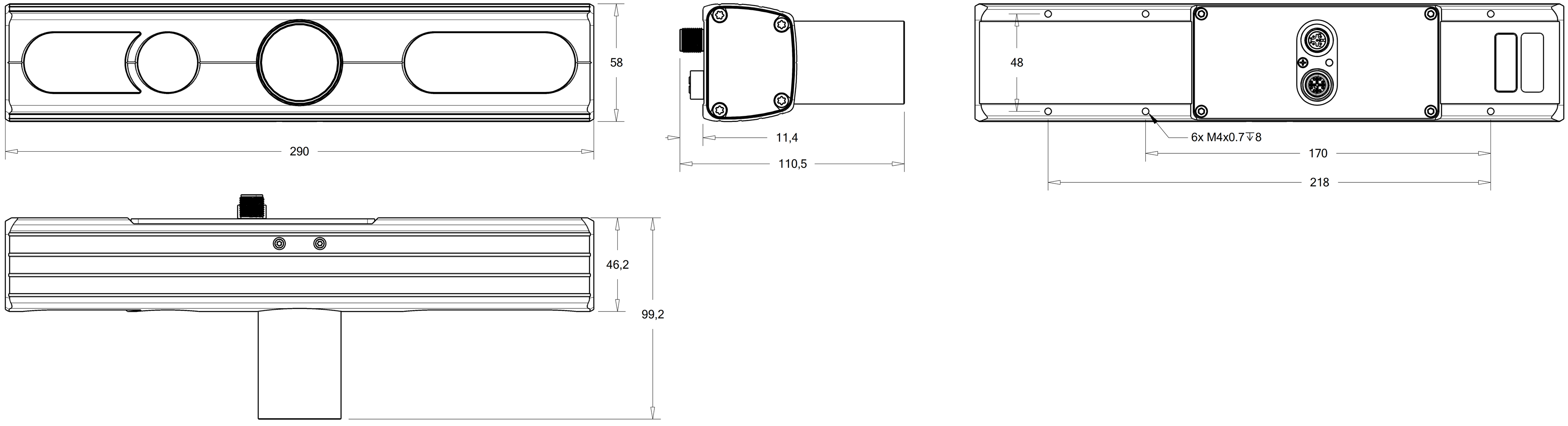

CR…-S
Weight: 1.16 kg
Case Dimensions:
../_images/cr-s_dimensions.png

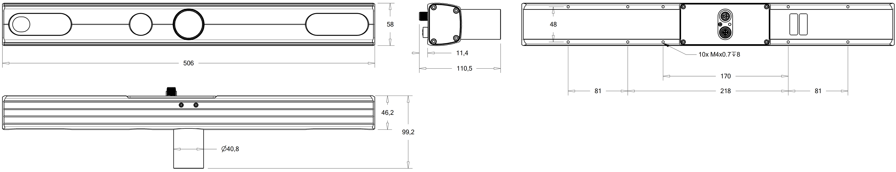

CR…-M
Weight: 1.66 kg
Case Dimensions:
../_images/cr-m_dimensions.png

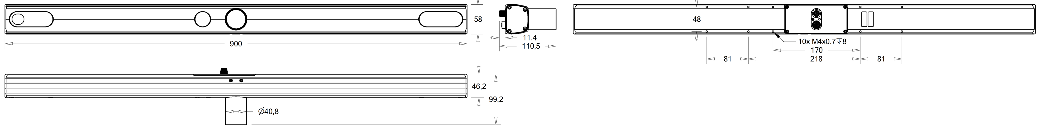

CR…-L
Weight: 2.65 kg
Case Dimensions:
